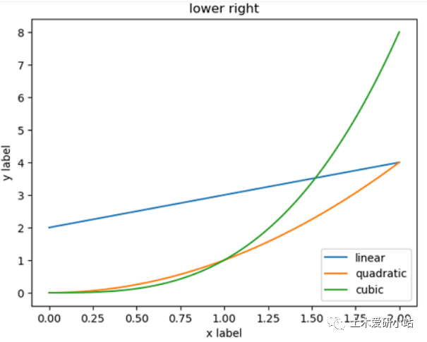

import numpy as np
as
x = np.linspace(0, 2, 100)plt.figure()plt.plot(x, x+2, label='linear')
plt.plot(x, x**2, label='quadratic')
plt.plot(x, x**3, label='cubic')plt.xlabel('x label')plt.ylabel('y label')plt.title("lower right")plt.legend(loc='lower right')
其结果显示如下:

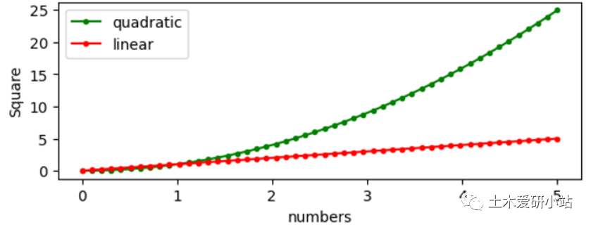

import numpy as np
import matplotlib.pyplot as pltplt.figure()x = np.linspace(0.0, 5.0)y = x*xplt.subplot(2, 1, 2)plt.plot(x, y, 'g.-',label='quadratic')plt.plot(x,x, 'r.-', label='linear')plt.title('uper left')plt.xlabel('numbers')plt.ylabel('Square')plt.legend(loc='uper left')plt.show()
其结果显示如下 :

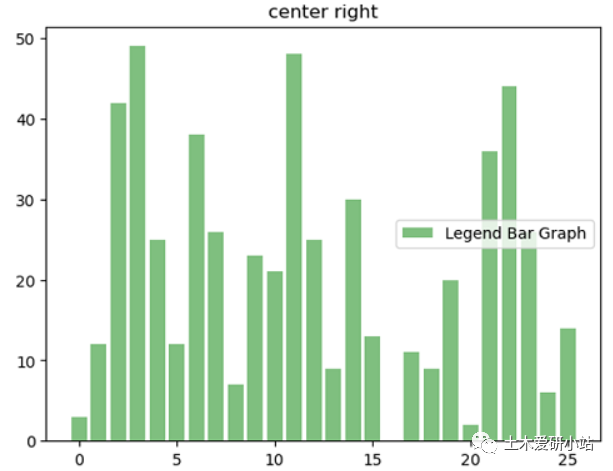

import numpy as np
plt.bar(np.arange(26), np.random.randint(0,50,26), alpha = 0.5, color='g', label='Legend Bar Graph')plt.title('center right')plt.legend(loc='center right')
其结果显示如下:
