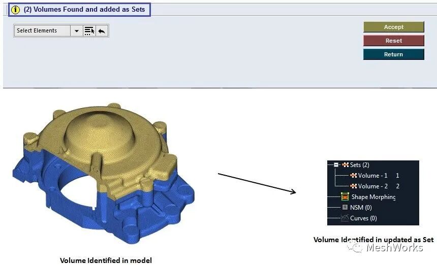

Check Volume Function
This New function can automatically detect and define volumes from an FE-Model or CAD Model.
This function is very useful in CFD modeling, where if a user needs to make some closed compartments, by using this function they can get to know how many closed volumes are there in the model.
All the detected volumes are added in separate sets.

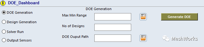

Auto DOE Function
Auto DOE function has been added in the File Tab.
DEP MeshWorks 2021强势发布!的图3
The Auto DOE function has the below capabilities-
i) DOE Generation, ii) Designs Generation, iii) Solver Run, iv) Output Sensors

DOE Generation
The function is used to generate the DOE matrix, for the user defined number of Designs from Max & Min range values of the parameters
Design Generation
The Design Generation function is used to generate the number of designs which is specified in the DOE matrix.
Solver Run
The Solver Run function is used to generate the Result file using external solvers like Nastran, Dyna, Abaqus and other solvers from the dashboard directly.

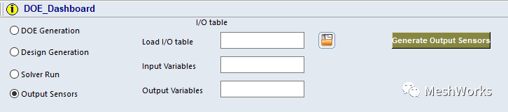

Output Sensors

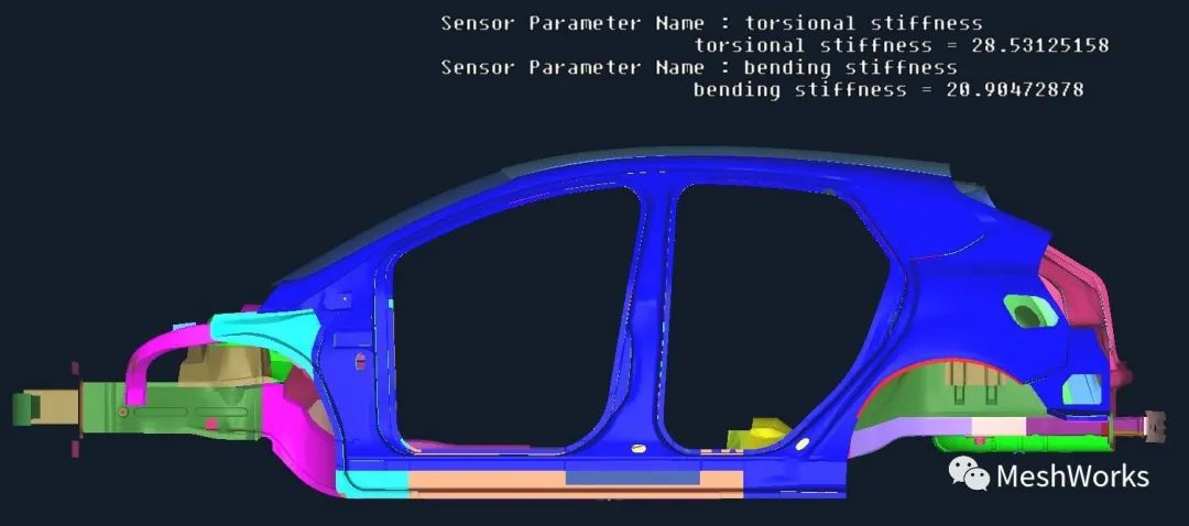

The Output Sensors function is used to generate output responses as a sensor. Using Design Advisor, when the input parameter  value is changed, the model gets deformed. In addition, in real time, the output responses will be computed and displayed on the MeshWorks canvas as shown in the below Design Advisor image.
DEP MeshWorks 2021强势发布!的图5

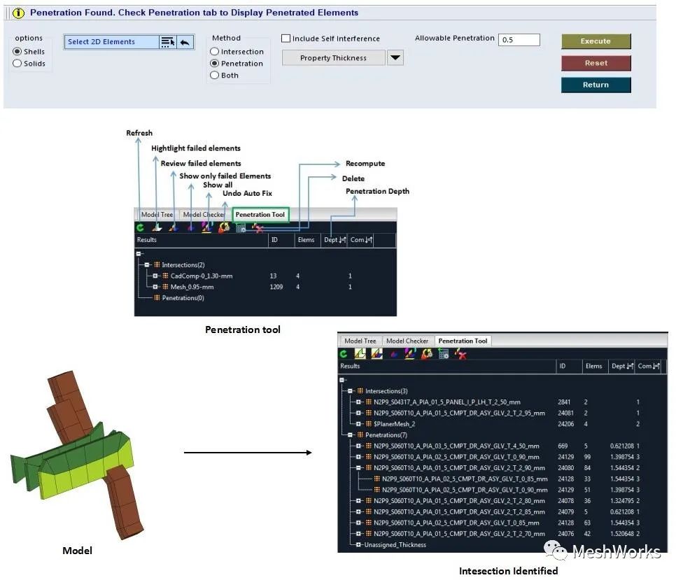

Self-Intersection/Penetration Function
New Intersection/Penetration Check and Fix Function has been added with features.
The Self Intersection/Penetration function can be used to initiate the initial check. A majority of checking and fix tools resides in the penetration tab which is next to the model tree.
DEP MeshWorks 2021强势发布!的图7

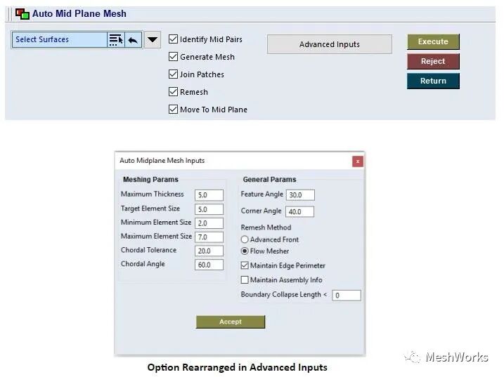

Auto Mid Plane Mesh
The execution time of Auto Mid-Plane mesh has been reduced drastically by 50% to 80%
  1. The Option is Rearranged in function.
DEP MeshWorks 2021强势发布!的图8

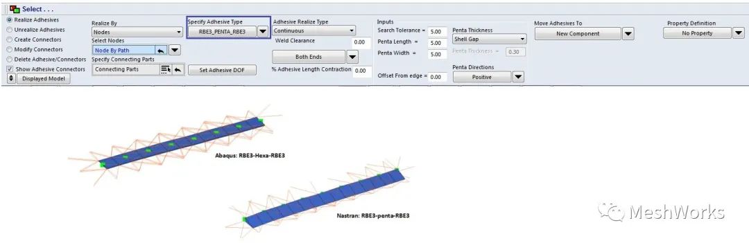

Adhesive bond
A new option in adhesive bond has been added
For Nastran solver interface :- RBE3+Penta+RBE3 Adhesive bond type is added, which creates Penta elements in between the connecting parts.
For Abaqus solver interface :- RBE3+Hexa+RBE3 adhesive type is added, which creates Hexa element in between the Connecting parts
DEP MeshWorks 2021强势发布!的图12

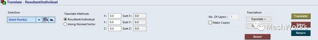

CAD point selection is added in the CAD translate and Rotate function.
CAD translate function

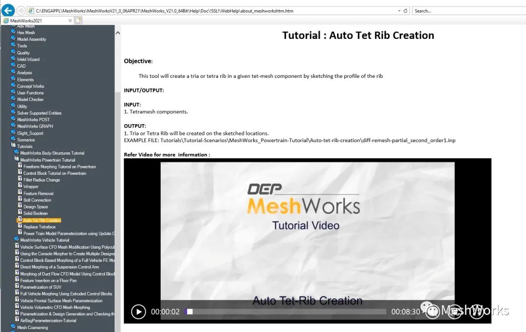

Help Document
    • Previously, MeshWorks help would open in an inbuilt Help Viewer. In MeshWorks 2021, MeshWorks Help document opens up in Internet browsers like Internet Explorer, MicroSoftEdge, Google Chrome, Firefox, and Opera.
    • In the Tutorials section of the help documents, explainer videos have been added.
DEP MeshWorks 2021强势发布!的图15
