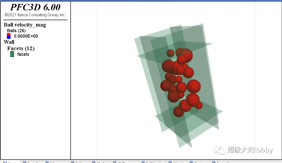

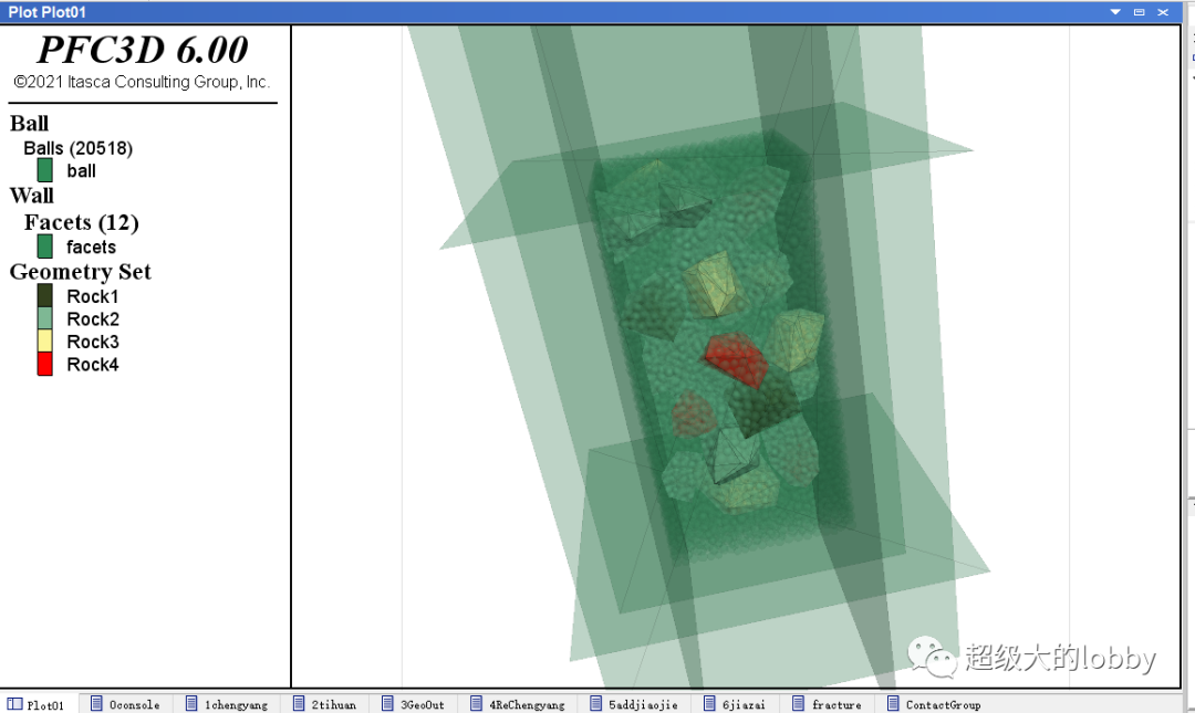

对于混凝土,集料一般不是很多,这里在空间中生成松散的ball代替集料。
model newdef par    width=2    height=width*2        rdmin=0.2    rdmax=0.4        poro=0.8end@par
domain extent [-width*2.0] [width*2.0] [-width*2.0] [width*2.0] ... [-height*2.0] [height*2.0]model random 10001
wall generate box [-width*0.5] [width*0.5] [-width*0.5] [width*0.5] ... [-height*0.5] [height*0.5] expand 1.5ball distribute porosity @poro radius [rdmin] [rdmax] box ... [-width*0.5] [width*0.5] [-width*0.5] [width*0.5] [-height*0.5] [height*0.5] ball attribute density 2e3 damp 0.7contact cmat default model linear method deform emod 100e6 kratio 1.5model cycle 2000 calm 50ball property "fric" 0.5model solvemodel save "sample"
结果如图所示:
【PFC6.0】三维Cluster模拟混合料混凝土的图1

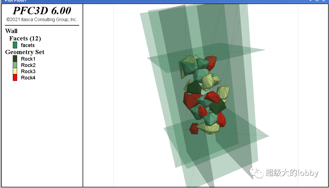

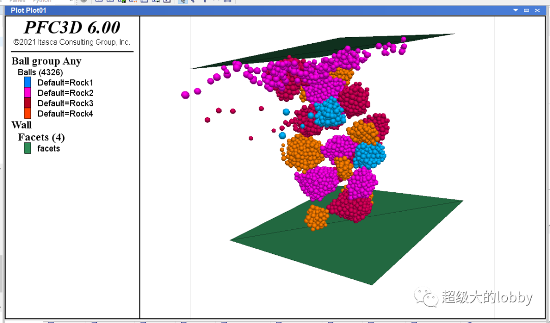

    这里我们把集料的范围进行提取,这里用的是clump export geometry方法。把四个clump形状提取出四个clump geometry。
model restore "tihuan_clump"
geometry delete
clump export geometry set "Rock1" range group "Rock1"clump export geometry set "Rock2" range group "Rock2"clump export geometry set "Rock3" range group "Rock3"clump export geometry set "Rock4" range group "Rock4"
model save "GeoOut"
如图:
【PFC6.0】三维Cluster模拟混合料混凝土的图2

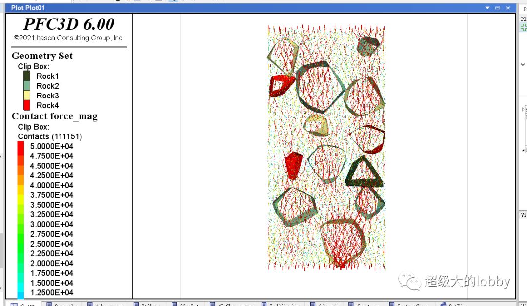

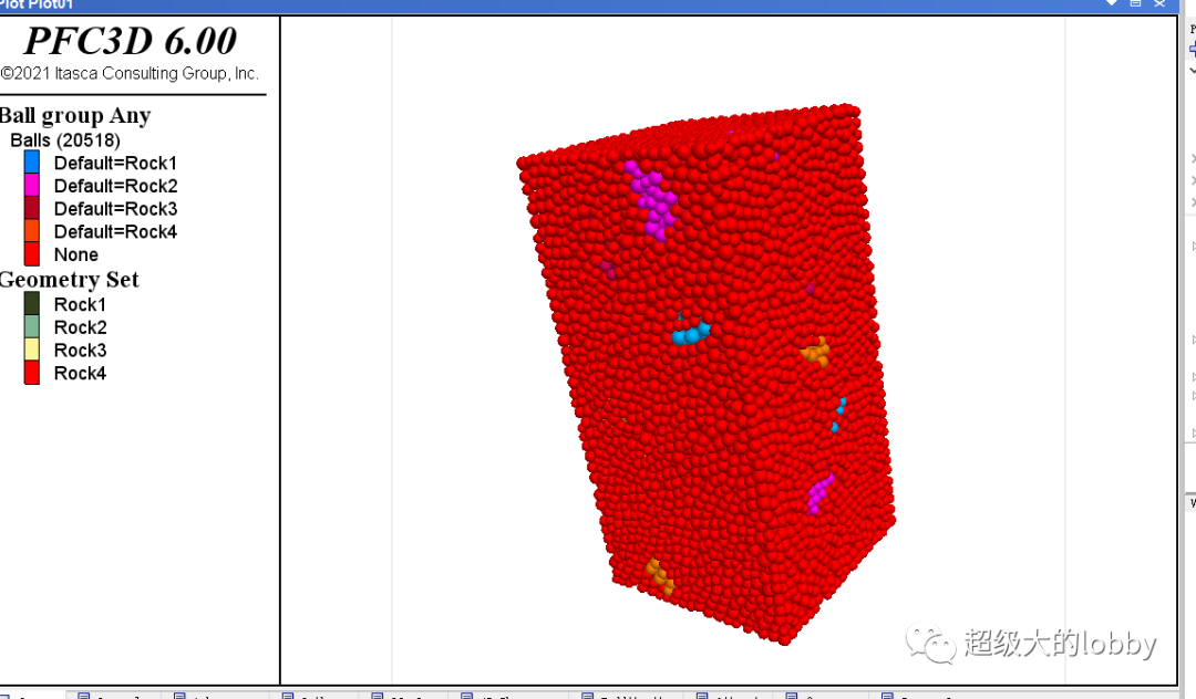

5 加胶结
    这里将不同geometry范围的颗粒进行胶结。
model restore "re_sample"ball group "Rock1" range geometry-space "Rock1" inside ball group "Rock2" range geometry-space "Rock2" inside ball group "Rock3" range geometry-space "Rock3" inside ball group "Rock4" range geometry-space "Rock4" inside
cmat default model linearpbond method deform emod 1e9 kratio 1.5 pb_deform emod 1e9 kratio 1.5 ... property pb_coh 10e6 pb_ten 10e6 pb_fa 50 fric 0.1 lin_mode 1cmat add 1 model linear method deform emod 10e9 kratio 1.5 ... property lin_mode 1 range contact type "ball-facet" cmat add 2 model linearpbond method deform emod 5e9 kratio 1.5 pb_deform emod 5e9 kratio 1.5 ... property pb_coh 15e6 pb_ten 15e6 pb_fa 50 fric 0.1 lin_mode 1 range group "Rock1" match 2cmat add 3 model linearpbond method deform emod 6e9 kratio 1.5 pb_deform emod 6e9 kratio 1.5 ... property pb_coh 18e6 pb_ten 18e6 pb_fa 50 fric 0.1 lin_mode 1 range group "Rock2" match 2cmat add 4 model linearpbond method deform emod 7e9 kratio 1.5 pb_deform emod 7e9 kratio 1.5 ... property pb_coh 20e6 pb_ten 20e6 pb_fa 50 fric 0.1 lin_mode 1 range group "Rock3" match 2cmat add 5 model linearpbond method deform emod 8e9 kratio 1.5 pb_deform emod 8e9 kratio 1.5 ... property pb_coh 22e6 pb_ten 22e6 pb_fa 50 fric 0.1 lin_mode 1 range group "Rock4" match 2 cmat apply
model clean
contact method bond gap [rdmin]
contact property lin_force 0 0 0
ball attribute force-contact 0 0 0 moment-contact 0 0 0model calm
model cycle 1
model solve
model save "jiaojie"
如图:

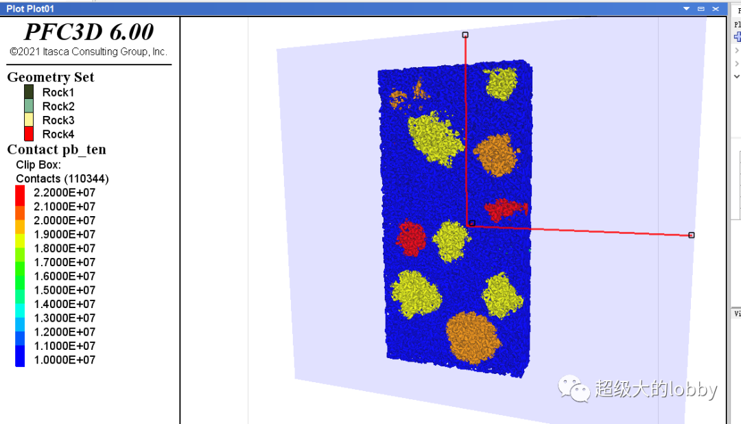

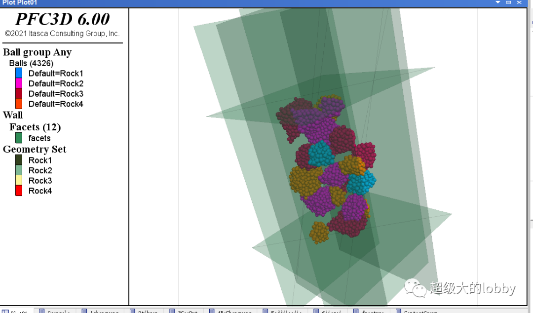

仅显示集料颗粒看一下:
【PFC6.0】三维Cluster模拟混合料混凝土的图5
显示参数做个剖面,也能比较好的看出效果:

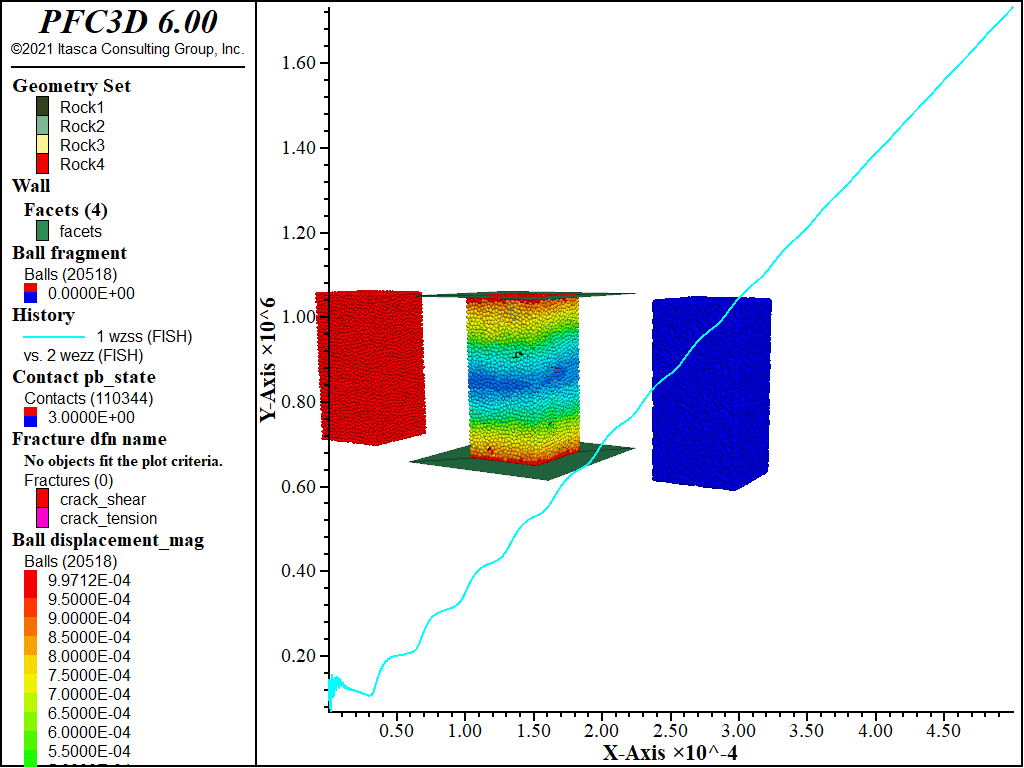

首先看一下整体情况:
【PFC6.0】三维Cluster模拟混合料混凝土的图7
    基本上是一个标准的胶结材料单轴的力学特性。

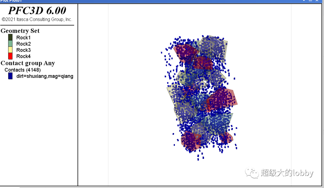

    写了一个简单的接触分组代码,可以筛选出当前接触中的强接触,分界的阈值时平均力的1.5倍。
    首先单轴工况下,竖向接触受力,横向接触基本不受力。所以这里认为横向接触都是弱接触。强弱的区分只考虑在竖向接触中
model restore "jieguo_6"
def GetAverageForce allForce=0 num=0 loop foreach ct contact.list("ball-ball") forceVec=math.unit(contact.normal(ct)) dip=math.dip.from.normal(forceVec) if dip<math.pi*0.25 | dip>math.pi*0.75 then allForce+=math.mag(contact.force.global(ct)) num+=1 contact.group(ct,"dirt")="shuxiang" else contact.group(ct,"dirt")="hengxiang" contact.group(ct,"mag")="ruo" endif endloop AverageForce=allForce/float(num)end@GetAverageForce
def ContactGroup test_num=0 loop foreach ct contact.list("ball-ball") if contact.group(ct,"dirt")="hengxiang" then continue endif if math.mag(contact.force.global(ct))> AverageForce*1.5 then contact.group(ct,"mag")="qiang" else contact.group(ct,"mag")="ruo" endif test_num+=1 endloopend@ContactGroup
    区分完后显示强接触和geometry,就可以发现集料在混凝土中的骨架性作用了。

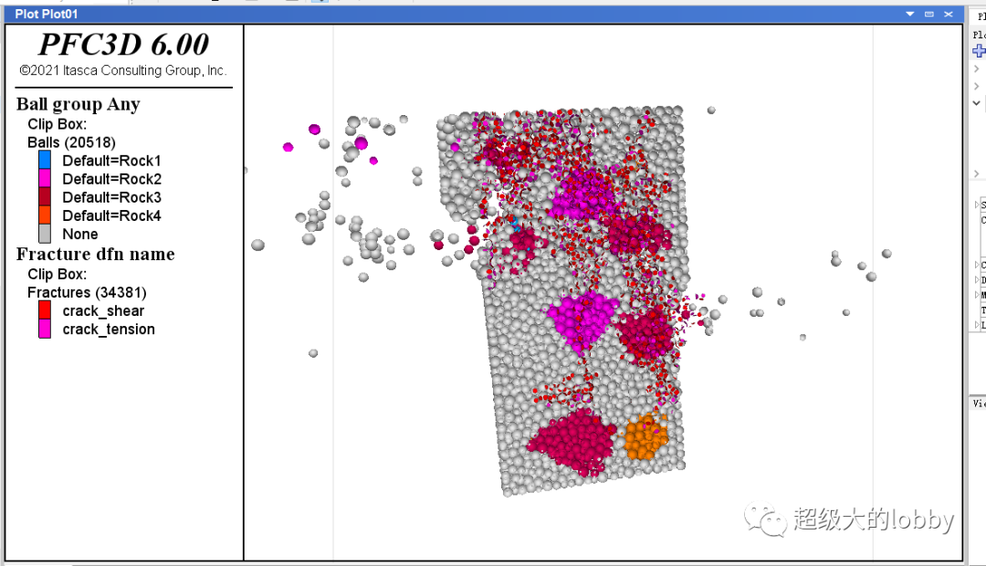

再看破坏,质地比较脆的rock1和rock2在破碎面上还是有一些破坏的
【PFC6.0】三维Cluster模拟混合料混凝土的图10
    取一个剖面分析。对于集料,需要有两点认识了。在当前参数情况下,水泥参数比较软,所以力主要由集料承担,所以集料也控制着破坏。材料失稳必然是集料发生了破坏。第二是破坏后,破裂面其实是会在集料边缘绕行的。
【PFC6.0】三维Cluster模拟混合料混凝土的图11
这里应该可分析的东西挺多的,精力有限,暂不做深入的分析。
