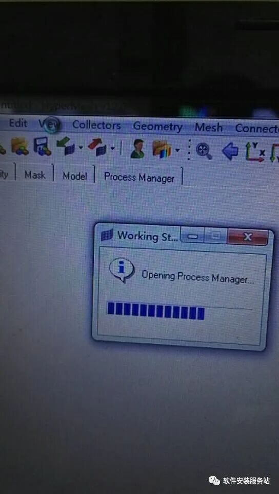

hypermesh 打开后,显示opening process manager。。

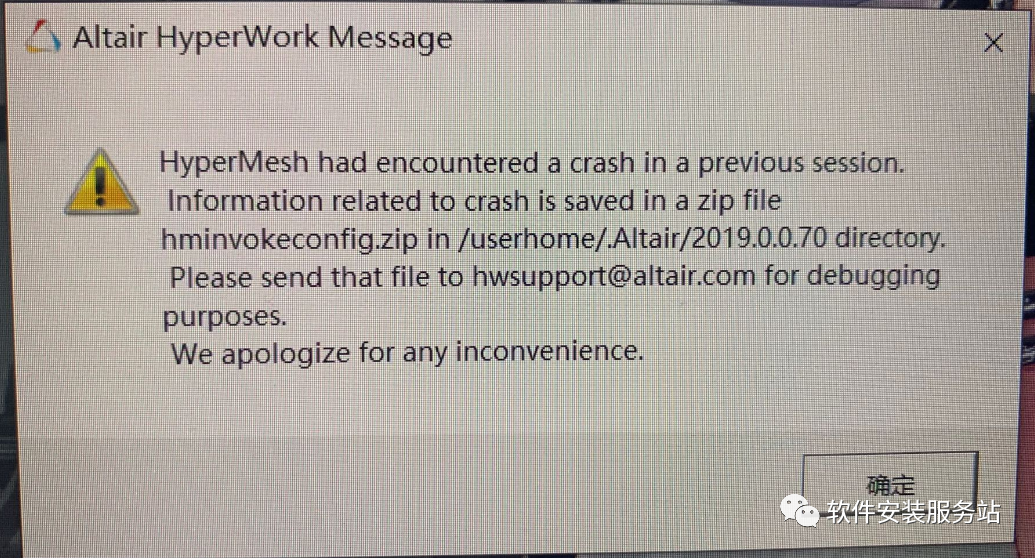

Error setting up framework: can't read "p_array(Model)":no such element in array
while executing
"raise $p_array($pagename)"
(object"::HM_Framework::NotebookObj1" method
"::HM_Framework::TGF_NotebookClass::ActivatePage" body line 3)
invoked from within
"$nb_obj ActivatePage $activeTabTitle"
(procedure "p_InstallNotebookTabs" line 36)
invoked from within
(procedure "::HM_Framework::p_FinishInit" line 22)
invoked from within
如何解决了呢,不能又重装电脑吧。

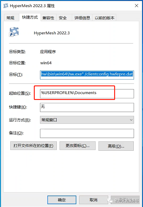

1.鼠标右键通过右击hm图标找到工作目录

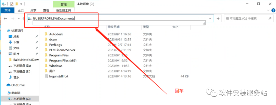

2.复制起始位置%USERPROFILE%\Documents,在C盘上的文件路径栏,回车

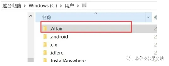

3.C:\Users\用户,删掉.Altair文件夹

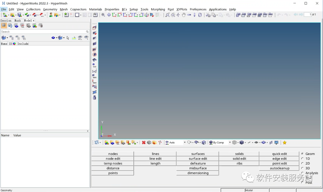

4.然后再打开软件,就能正常使用了
