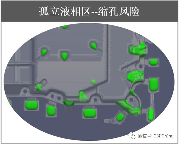

Cast-Designer 热分析与DFM免费报告:
压铸PQ实战分享 by 敖鸿鹄的图1
